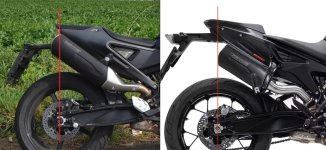

Today another box showed up; it's the Remus NXT Duke 890 version.
To me the Remus 801 version is too long; the Duke version is shorter and without the big heatshield; to me it's purer; I like it.

Hmm, had to put back the Remus, when I was tightening the link between the exhaust and catalyst, the gasket started taking a beating for some reason.
Not sure if the CFMoto 800nk "link" doesnt match this
This is the result, I made a simple test bracket out of an aluminum plate, the distance between the middle of the holes is about 40-42mm. Using m8 screws and locknuts.
Tomorrow I am going to change the screw on the silencer bracket to a bit longer and add a washer so it’s the custom bracket is more straight.
Didn’t film the sound, but god damn is loud at low rpm’s and then when revving it feels to be less loud or something 🤪
It follows the lines of the bike perfectly.
