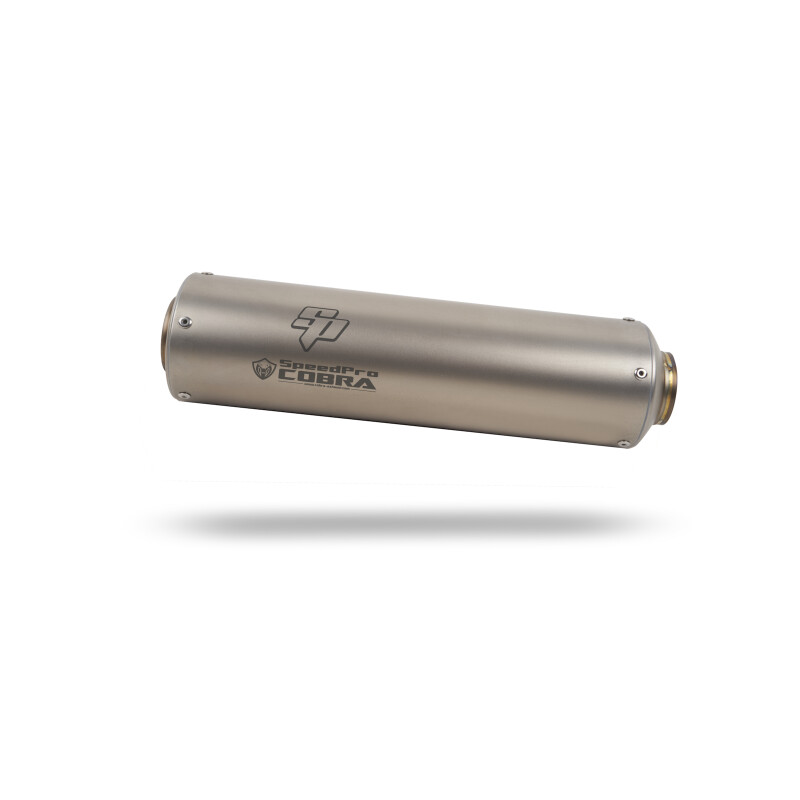

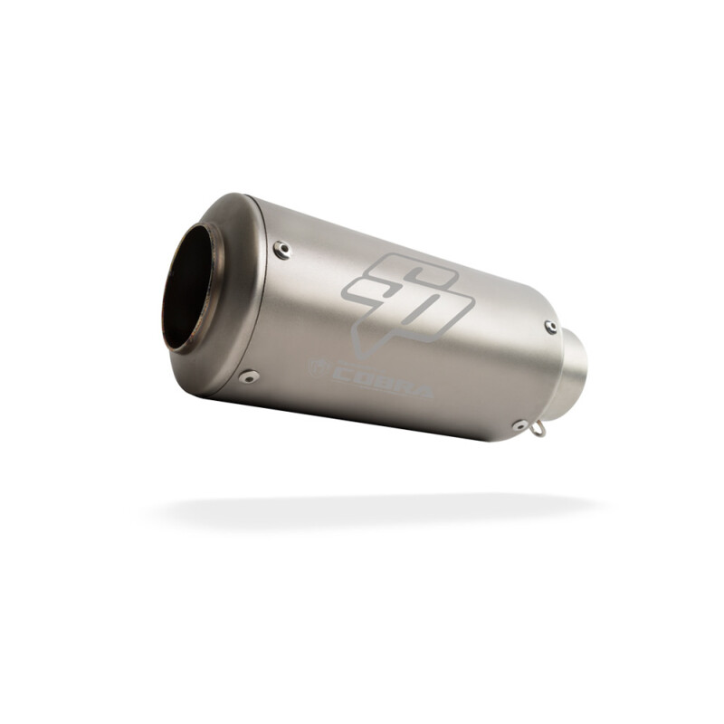

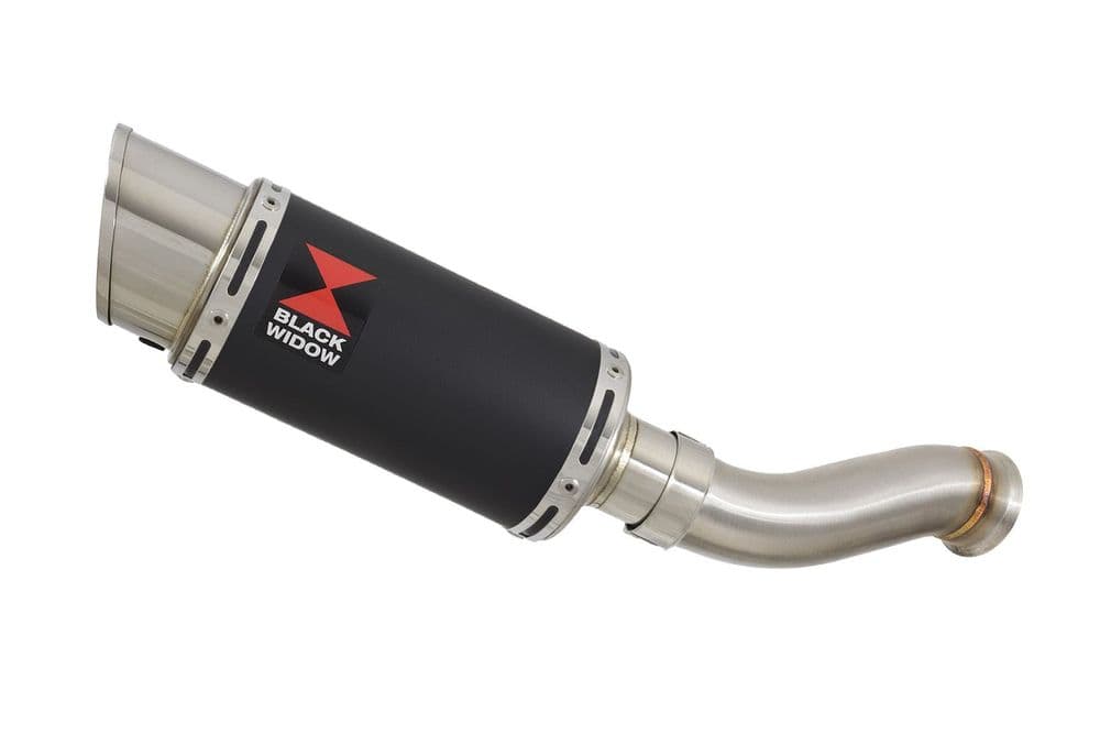

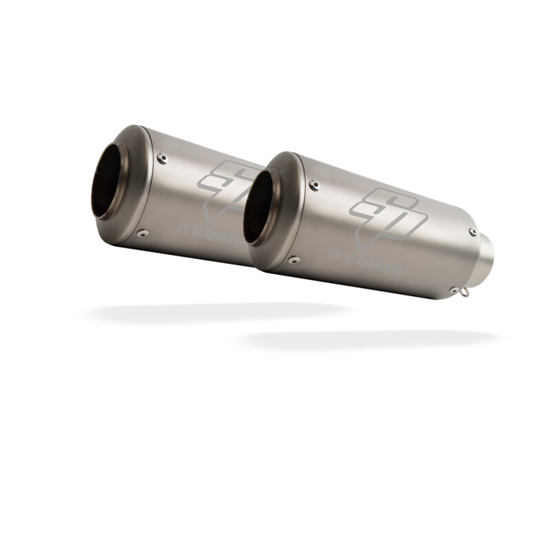

I’ve made a list of short slip-ons.
-Ugly and shipping from UK
Does not specify the year
I’ll add to the list if you have more tips.
There’s also a list of more options here, however, not all of them are for the 2023/2024 frame and some are “melting high”.
From the list above:
Austin racing - only high exhausts
Scorpion - Only high exhausts
Spark -double, semi high

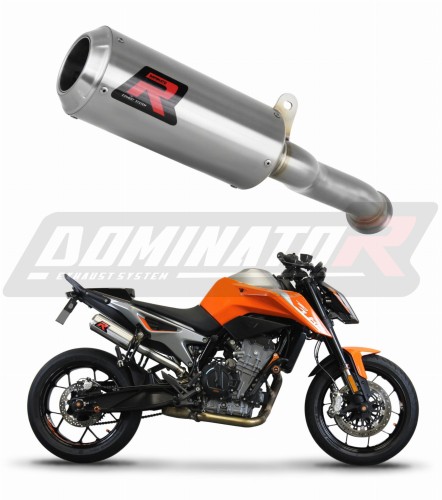

Update: I’ve been in contact with three different exhaust manufacturers and none of them have any active time plan to release a system for the 801. Remus has one on the Husky site but can’t answer if they will make a non legal version. Same goes for Leovince.
In communication with Dominator exhausts we also concluded that the Duke 790 slip on won’t fit the 801 since the attachment point is different.
