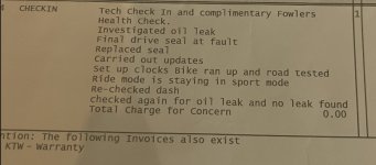

I just checked my repair and it said they had traced the leak to the gasket on the final drive casing, which was subsequently replaced. See below:
3000 miles later, no leaks so far.
