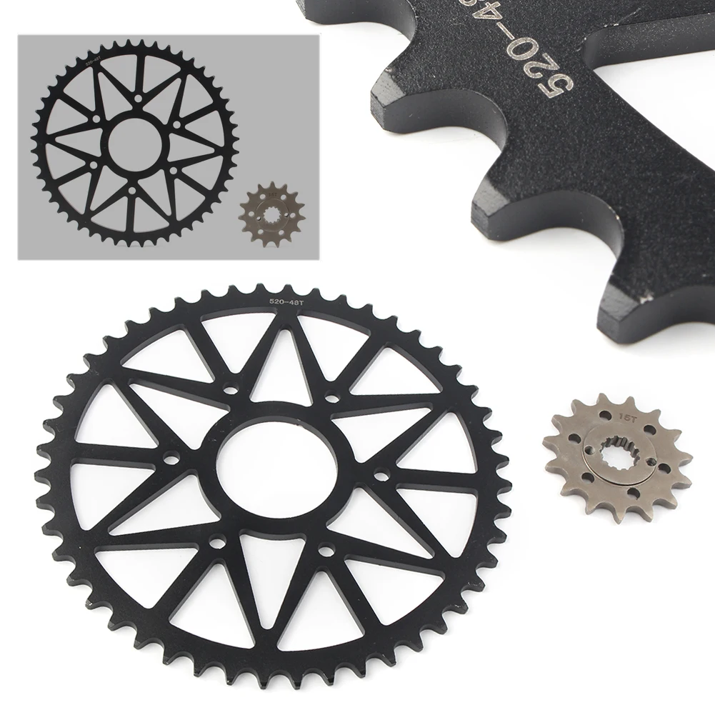

Yes, the inner holes are all offset with the center of the countersink for the nuts by exactly 1.225 on the rotational axis.
If i were to comment, I would say this increases the longevity of the sprocket should the incorrect torque be applied to the nuts resulting in elongation of the bolt holes under high wheel torque situations.
So technically, the manufacturing the tolerance might be a +/- 1mm and specifeid to +2mm/-0mm from countersink center resulting always in a positive offset.
Speculation aside, I would note that the manufacturing quality of the KTM sprocket (or whomever makes it for KTM) is better than most.

From what Ive gathered the RFA ones are disigned to work with the aluminum disc in order to make it look like a stealth, and the RFE are not.
The surface looks completely different in your pic than the one I have here:
Yeah, that is definitely a different surface finish than this one.
I don't like the shape of it... I think I will return it and get something else.
Yeah, the rear from driven is for sure nice.
Without having fully tested it, the driven front definately makes a good first impression.
