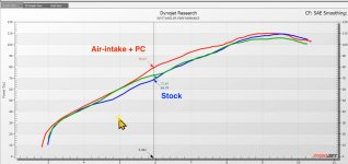

@animals21 here a link to a video that might be of interest to you.
It's about tuning options and shows also several dyno-results of a Duke 890.
It seems the Rottweiler air-intake (pic above from yonsson) is indeed a quite interesting possibility to gain some horses.
A screenshot from the video ("PC" is Power Commander)
I went through the video yesterday and through the links in the comments. Most interesting two are here:
https://www.motorcycle.com/products...iler-performance-power-plate-for-ktm-790-duke
https://www.motorcycle.com/products...intake-system-for-the-ktm-790-890-duke-review
shortly we can say, that open lid filter ("performance power plate") with dynojet makes just a very slight power increase, I would say almost nothing for the money. If you want really a noticeably more power, you have to go with performance intake system (picture was posted yonsson up there) and rottweiler dynojet with their maps. Disadvantage is "motor warning light" on the dashboard, but you get quite a lot of power.
From my understanding the engine warning light on the dashboard lights up because of the disconnected oxygen sensors if you'll use a Power Commander.
With the "performance intake system" and the Coober LM ECU (instead of the Power Commander) it should work fine without the engine warning light; and the power should also increase noticeable.
