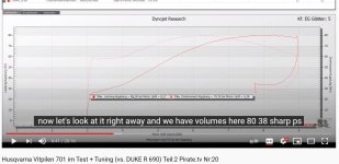

You opted to keep the stock cat as well? I think this helped with your midrange. I think the Akro exhaust with the center cat-like section might do a little better, but with the decat in place, I think that's second best to maintain midrange. But Pirate's limited edition decat was excellent at midrange, but I don't believe is available. Attached is their dyno run.
Thanks for posting these. Looks like your tuner did a good job.Pirate Racing 701 With Akro Cat And Stage 1 Dyno.jpg

I believe pirate racing talk about needing a bigger chamber than the Arrow at that point in the exhaust to be optimal. I think they might use the full Akro system from the duke 690 R. This has a much bigger chamber than the Arrow.
I really don't think you can really get better than the stock cat but you can get lighter.....
The Remus pre muffler is meant to have enough volume for midrange power by less weight and less backpressure for more high-end power, also.

If I recall from the very poorly translated video, their decat had a better midrange than the Akro, but the Akro had a better top-end with a dip in the midrange.
