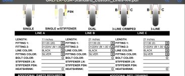

In the picture it looks like you went with 3 piece brake lines. Can you tell me more about your line set up.
I know you're asking the OP, but to me it looks like a one piece that splits under the lower triple.
It is a three piece from the ABS pump and stock line from the master cylinder to the pump. There is a short line from the pump to the t fitting on the underside of the lower triple and then the two front lines.
The whole reason I did that is because due to long wait times and all this supply chain nonsense I ordered the lines before I had the front end built and wanted to be able to just replace the lower lines if the fittings or length needed adjustment. What I should have probably done is keep a single line like the stock one and then probably just use a double banjo bolt and looped a short line over to the other caliper like the Ducati 848 evo uses that I got the calipers from.
I do need to adjust the lower line length so I have to order some more lines from Galfer… thankfully I don’t have to mess with the line to the abs pump because getting that line installed was seriously the hardest part of the project.
Fair warning though you can’t properly bleed the brakes without the husqvarna scan tool to run the abs pump so I plan on riding to the dealership once it warms up and having them bleed the brakes because I just can’t get them bled to my liking.
I understand your thoughts on the stock line with a jumper but the stock 90 end won't work with those calipers. Would you happen to have the info or lengths of the short line from the abs and one to a caliper?
I would use the stock line because of the end you mentioned but would probably copy it with a different end to get the length spot on… I’ll have to try and find my galfer order form for the details. Currently the lines to the calipers are about 2.5 to 3in too long
This is what I used, like I said earlier I think the lower lines are about 2.5-3 inches long and I think I would do it different if I had to redo it.. the line from the abs pump to the t fitting I think is about 1 inch too long…
