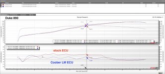

Question for the Husky veterans here: With a decat, straight-through exhaust, I think the Coober LM fuel module only works during closed-loop operation (low/mid RPM lambda signal corrections) and does nothing for high RPM fueling ratios. If true, does a decat exhaust make high RPM's too lean for the ECU fuel tables or are the OEM tables rich enough (or adaptable enough) to cause no damage from excess leanness?
I would ask Coober, they normally reply promptly. I have the Coober btw
I have read/heard conflicting information regarding whether the Bosch ECU can adjust the AFR values enough even without the cat; however, an error message will appear on the display. Here a dyno-graph showing the AFR values with and without the Cooper LM ECU.
