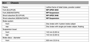

i was under the impression the stroke was 142mm

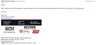

In the UK, Brooksuspension.co.uk. I do not know if you can get YSS stuff in US but the part number is shown on the box in the second pic. Yes sorry 142mm of travel. It’s been a long day…..
:( no luck from the official us importer. I emailed Brooks today; I couldn't find the fork springs (L0365A0755350X) on the website anymore.
