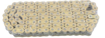

Hello folks....I would like to improve the look of my Svartpilen and also the functionality with some subtle changes. So, I thought to replace the chain with a better quality, nicer looking one. I would like to replace the brake discs with some wave ones (together with the brake pads). I would also like to replace the rear sprocket with a dual material one. For the chain replacement, I thought about a gold Regina one. But, I'm having trouble finding a set of wave discs that is compatible with the Svartpilen 701. Also for the rear sprocket, I can't find a dual material one to fit the Svartpilen 701.
I'd like some opinions about the Regina chains, and some guidance for wave brake discs as well as dual material rear sprocket (40T).

Ok, Galfer brake discs seem to be very hard to find here in Romania, so I ended up by ordering some original Husqvarna Power Parts paired with some EBC sintered brake pads. They are also made by Galfer, so basically is the same thing. I had to order them as for a 701 Supermoto since Husqvarna doesn't sell them for Svartpilen 701 😑, even they are using the same brake discs. The part number for the front one is 76909960000C1 and for the rear, the part number is 27010060000. For the chain i'll go with a Regina one, but i can't find a decent rear 40T sprocket other than the original one. Supersprox RST990 40T seem to be out of stock anywhere.
