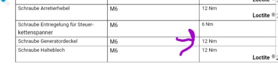

Normally sprocket guard doesnt need to come off at the first service... (on my 401 many of the screws needed re-torque'ing so...)
Torque spec is in the manual... there are two tables with torques, the generator cover is in the motor part.

Why do you say not to? This is precisely why I asked…because I’m not sure to working on bikes and tend to follow the manual (which doesn’t mention Loctite, 243 is blue)
I also noticed last night that the torque is in three different places in the manual and has three different torque values.
Wheels, pg 122, 11 nm, 8.1 lbf ft, 97 in lbs
Engine, pg 173, 10 nm, 7.4 lbf ft, 89 in lbs
Alternator cover, pg 232, 12 nm, 8.9 lbf ft, 107 in lbs
Just thought it was peculiar… I’m gonna do the 12 nm, like you’ve pointed out. Gonna clean up the chain lube that’s in behind the sprocket cover first. Hopefully it gets warmer soon. It was snowing today lol!!!
