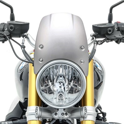

This is universal screen on eBay is claiming to be for a Svartpilen 701. Anyone tried one? I might...
It says universal mounting kit . Most of those mount to triple clamp bolts( ours are facing the other way) or headlights bolts (which are covered).. that's why the only specific screens for the svartpilen 701 have large crazy brackets. Most other scramblers don't have a headlight shroud.
If you want universal try one with handlebar clamps. Or if you get that to work somehow post pics
