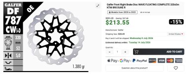

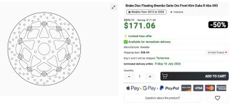

I can buy for a very good price front 320mm brake discs from KTM SMT 890 (KTM number A67509060000). Will they fit on Svart 801?
From what I know the 890 SMT brake discs are 64mm (inner diameter) instead of 52mm and they have an offset of 9.7mm; the will not fit.
Additionally I would generally avoid stock/OEM Galfer discs as they generally tend to warp (on several KTM models).
My original front discs are definitely not completely flat. The brake effect at slow speeds is annoyingly choppy.
I know of someone who had them replaced under warranty several times; and he ended up with after market discs to ultimately solve the problem.
