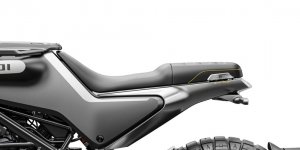

Here is the Stock Svartpilen 401 Seat:

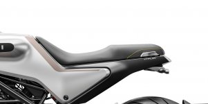

Here is the stock Vitpilen 401 seat:

Yes to my eyes the profile is almost exactly the same between Vit and Svart. The slope up to the pillion section appears a little bit less steep on the Vitpilen seat which I suppose could induce a bit of leaning forward as is conducive to the Vit's riding position, but it's probably minimal.

It seems almost exactly the same profile as the Svartpilen, just one piece... or am I missing something?
