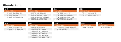

There is no special type for Svartpilen in Ohlins catalogue. So can I take suspension dimensions for 790 Duke? I know, that front forks are better on Svart, not sure about the rear, but dimensions should be same???
Front forks inserts type
NIX 30 Street Cartridge Kit FKS 509​
Rear shock type
STX 46 Street KT 789​
Does anybody made this swap?

Long story short - I asked some companies and I am waiting to have all offers. Slight risk I see, that there is almost nothing directly for Svart. Is anybody sure, that what fits 790 Duke (any year??) will fit Svartpilen?
Thank you.
Oh, great. I would like to do mainly the rear shock. The 7746 should fit. I hope. KTM has it listed on their websites like Duke790/Svartpilen801. Looks like it is adequate quality as Ohlins STX46 KT790. I will see, if I can get some discount somewhere. I also quote K-Tech and ... eeeee ... the English one ... forgot the name ...
