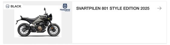

But maybe we just need to be a little more patient with the 801 until the 2025 "Style Edition" is presented... / here a screenshot from the official Husqvarna spareparts-finder; still with a pic of a 401...
I bet it’s on pause until Bajaj reviews everything and they get their house back in order. It would make sense to do spokes on the svart and maybe a larger front.
If the Style Edition will come with spokes, I don't think they will change the size (to 18" or even 19"). It would change the geometry of the bike too much; it would be less nimble; and that's one of the outstanding features of the 801.
Most likely, I really wish they would have positioned the Svart to compete with the triumph scrambler XE and gave it some off-road capabilities. It is so close to the vitpilen. Same with the 401s, if they would have brought the svart closer to the 390 enduro r it would be so cool.
