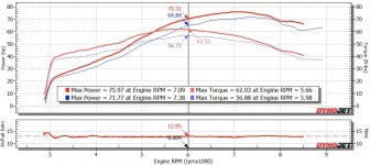

I like the drop-in aspect of the cam and the dyno looks sweet as well. Not worried about the very top end pinch, as the rest of the spread looks great.
Anyone have any experience with this cam or his company? About $650 for the cam. Expensive for one small cam . . .
Thanks.
I wrote the company, and they were very adamant about the need for optimizing AFR with this cam, and they reference it in their doc on the cam too. Dropping in the cam without a tune and a PCV is prob a bad move.
Do you know if he had a dyno tune on it?
